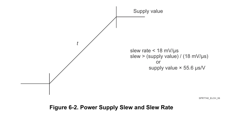

    2.Is there a power supply ramp requirement to be followed for power-up?
    Refer to Power Supply Slew Rate Requirement section and Power Supply Slew and Slew Rate figure of the processor specific data sheet

    Additional inputs on the supply slew rate:
    The power supply slew rate is only defined for power-up. This slew rate limit is required to prevent the ESD circuits implemented on the power pins from accidently triggering. This is not a concern for power-down.
    I am adding some additional inputs related to power-up sequence
    The maximum slew rate of 18mV/us is defined in the datasheet snapshot inserted above. We do not define a minimum slew rate for power rails.

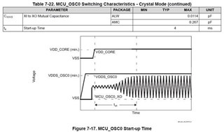

    Customer follow SK-AM62B-P1 design and use same PMIC and found MCU_OSC0 clock start up timing is not matching the sequence we describe in Data Sheet.
    This is confirmed on both customer board and TI EVM.
    MCU_OSC0 is supposed to be clocking after VDD_Core rising but the waveform measurement shows it is ahead VDD_CORE.
    Customer would like to get the explanation from TI for this.
    Could team check this or we need to revise data sheet?
    The datasheet shows it not starting until after the core voltage because there are some cases where the oscillator may not start until VDD_CORE is valid. In most cases it will start as early as VDDS_OSC0, but this may not always be the case.
    This diagram in the datasheet is showing the maximum start-up time, which must include the case where the delay is based on VDD_CORE being valid.
