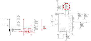

We are using LM9044 for O2 sensor and was working on some options for short to battery and short to gnd protection.
1. Can you please review below scheme for short to battery and short to gnd protection, suggest if changes are required or if there is any other way to implement the same. Since the datasheet mentions use of series resistance from 100 ohm to 1k for input filtering, same resistors can be used for current limiting for clamping diodes?
2. On pg 9 of datasheet, for input filtering, it is recommended to use filter for differential mode as well as for common mode but in application circuit, there are only two caps are used one across inv and non-inv lines and other from inv to gnd. Do I need to add one more as shown below or two caps will serve for both common mode and differential mode.
    Yes, the same 100ohm to 1kohm resistors may be used for both, input protection and filtering.  But since both inputs are already internally protected against shorts to supply, you do NOT need the diodes shown on your schematic unless the shorts are to voltages beyond the supply rails - see below.
    In addition to the differential input filtering cap, C1, you do need both input common-mode input filters using C2 and C3.

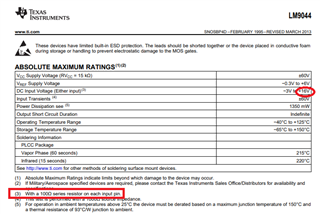

    a. If we consider the battery voltage  (or short to voltage) up to 28V and supply is still i.e. Vcc = 14V. Do we need to add protection diodes in that case?
    b. What is the current capability (or injection current) of internal protection so that the series resistor selection can be done within 100 to 1k.
    Sunney
  • The Absolute Maximum rated input voltage is 16V (see below) so you may NOT short the input to Vbatt of 28V.  Since you do not show whether Vcc includes 10kohm series resistor or say if Vcc can sink current, you will need an external overvoltage protection.
    In such case, in order to protect the input you must add 15V Zener diode together with extrenal ESD diode to clamp the input voltage below 16V.
    In this case, the series input resistor value needs to be based on the rating of the external DZ and ESD diode you use.
  • Hi Marek,
    Sorry for not showing the complete circuit.
    Here it is.
    Vcc has 15kohm series resistor.
    There is ESD diode ESDCAN24 which I have not shown earlier.
    As per your suggestion to use Zener diode, I have marked the schematic above in RED.
    And have done some calculations in order to select the zener diode and series resistor.
    I have considered battery voltage range 24-28V.
    Since the inputs are 16V protected internally which comes under Absolute maximum rating, I have used 14V zener diode.
    Vin (V) Vz (V) Rs (ohm) Iz (A) Pd_Rs (W) Pd_Zen (W)

  • Yes, you could add 14V Zener diodes directly at the input terminals BUT consider the effect of  their junction capacitance on circuit performance - Cj1 and Cj2 are now in parallel with C3 and C2, respectively. Also, in order to clamp the input voltage, Zener diodes must be very fast so you probably need to use instead transient voltage suppressors, TVS.
