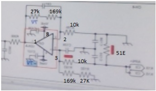

LMC6482: LMC6482 as a DIfferential amplifier in my end application for analog current sensing application, I have received a failure such that opamp 6482 IC, its series resistor 10K got failed along with shunt resistor also open
Part Number: LMC6482
In My Application
   LMC6482 as a DIfferential amplifier  for analog current sensing application, I have received a failure such that opamp 6482 IC, its series resistor 10K got failed along with shunt resistor also open.
   Shunt open is due to excessive current, it is clear but I am interetsed to know the reason why series 10K resistor, OP AMP IC failed like its output is always  + Vcc range.
   Kindly suggest us probable reasons, how can I simulate same case at my in house lab
