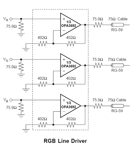

I am looking for splitter IC for analog RGB.
Resolution is 640 x 480
Do we have any IC which can split an analog RGB signal into 4 ?
Any advice will be appreciated.
Jin
Jin,
You will only need one common set of input terminations (at the end of the line). Match your trance impedances and lengths.

Can THS7372 be used for this purpose ?
https://www.ti.com/product/THS7372
Jin
Hello Jin,
Here is a link of our video amplifier portfolio. As mentioned, the OPA3692 is a good choice got generalized application, but if you want integrated filtering or other specialized functions, you could look at our 3/4/6-channel Video Amplifiers.
