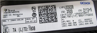

I have parts from both the Aguascalientes and Malaysia assembly site and each part has a different lead-frame design.
Will this affect the parts functionally?

Hello Dorian,
Different assembly sites can have different build materials, depending on their capabilities.
I can confirm that the leadframes are different between the Malaysia and Mexico sites, and that the X-rays resemble the leadframe drawings.
Everything is the same except the leadframe - same die, mold compound, die attach, bond wires and plating.
So, essentially, they are identical and will perform the same.
