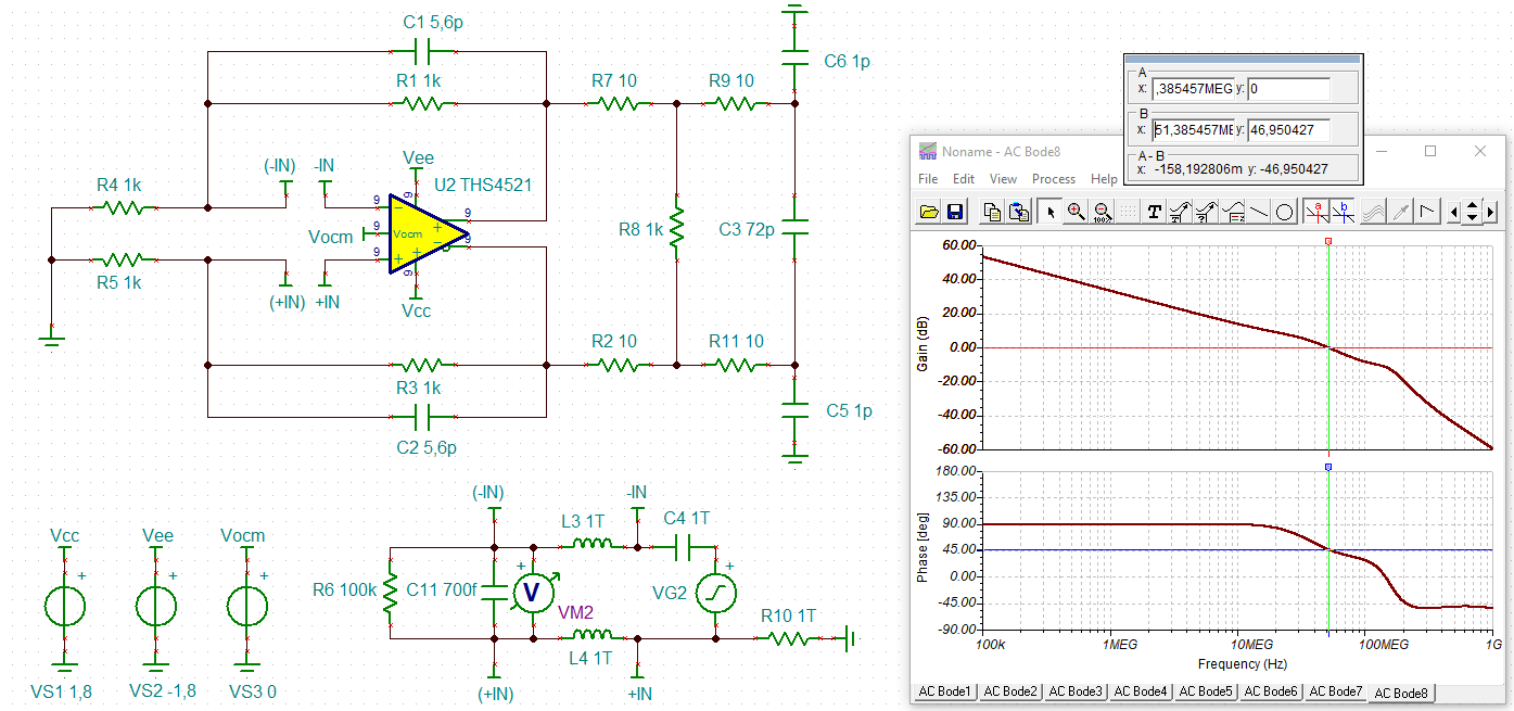

I add protection diode D3 and D4.
Will the leakage current of it will impact accuracy?
Hi Xiaoqiang,
your circuit isn't stable:
Also, R42...44 look a bit too big.
What are the protection diodes for? Protection of THS4521 against higher supply voltages of OPA810? Why is D4 is mounted then?
What do you want to drive with the THS4521? And ADC? Which ADC?
Kai
Well at some small level they will - that leakage will add to the specified bias currents for the THS4521 where the differential output offset effect will be the mismatch between the total leakage on each side - if your temperature is not very high, should be a very small effect. You don't show your Vocm control voltage, but with only +/-1.6V supplies be careful about its range.
The THS4521 is not a very low offset voltage device to begin with, improved by both the THS4551 and THS4561

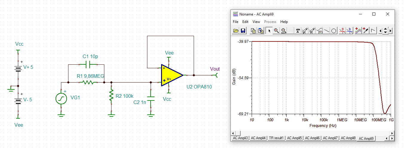

1) R42...R44 big. --> This is designed as oscilloscope probe.
2) What are the protection diodes for? -> Protection of THS4521 against higher supply voltages of OPA810, yes. When OPA810 output about +/-5V.
3) ADC: ADS4222. using 1.8V power supply.
The Vocm loop is a seperate amplifier with its own headroom to supply constraints - the THS4521 requires 1V to the supplies, you are only providing 0.35V so the Vocm loop will not operate correctly - this is from the 3.3V spec table,
Normally, these designs use 3.3V single supply on the FDA, that again violates the headroom trying to use a 0.95Vocm - this is why the more recent parts like the THS4551 and THS4561 really tried to move the Vocm headroom closer to the negative supply. I think you need to change parts and then pick this up again.
Hi Xiaoqiang,
In this case you must frequency compensate the voltage divider. Otherwise your frequency response will suffer from the input capacitance of OPA810:
Like this for instance:
Kai
