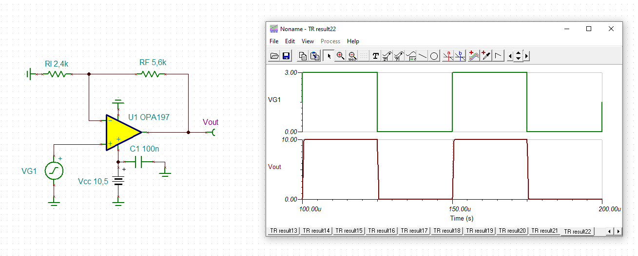

    For my application, I am looking for a precision opamp.
    Input to opamp is 3V DACOUT. Expected output swing is from 0V to 10V.
    How to decide on the right opamp. Please suggest.
    12bit DACOUT specs from C2000 MCU is as below.
    Vidhya
  • Hi Vidhya,
    I would take the OPA197:
    vidhya_opa197.TSC
    Keep in mind that the C2000's linear output voltage range is 0.3V...VDDA-0.3V.
    Kai

  • Hi Vidhya,
    yes, of course. As the input voltage in my simulation is centered arround 1.5V the output voltage will also be centered arround 5V.
    Another method to analyze the behaviour of this circuit is to analyze the "DC transfer characteristics":
    So everything is fine Relaxed
    Kai

    The OPA197 that Kai recommends is easy to apply in a single supply application and provides highly precision performance. The OPA197 linear output voltage (Vo) swing range is specified as (V–)+ 0.3 V < Vo < (V+) – 0.3 V, for RLOAD = 10 kΩ and VS = ±18 V. Therefore, the supply will need to be somewhat greater than 10 V to accommodate the 10 V Vo requirement of the application. The Vo swing range should be very similar to that obtained with VS = ±18 V even if Vs is lower. If RLOAD is lower than 10 kΩ such as 2kΩ, then Vo will be more restricted as the datasheet indicates.
    Regards, Thomas
