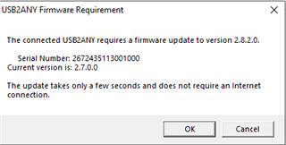

I have been trying to interface a DAC81416EVM using a USB2ANY. When I first connect the USB2ANY to the computer, I receive a notification to update the firmware to a newer version.
However, when I open the DACX1416 EVM GUI, I receive the following message:
If I do change the firmware to 2.7.0.0, then the GUI will open with the device in hardware mode, but the device doesn't actually seem to be connected (does not read in correct device ID, does not write to registers, USB2ANY light blinks).
If I do not change the firmware to 2.7.0.0, I am unable to take the device out of demo mode and receive this error.
Both the USB2ANY and DAC81416EVM are brand new, so I think it is a firmware issue rather than a hardware one, though I could be mistaken.
Please let me know if there is anything I can do to fix this problem!

    What two programs are you using? I understand the DACx1416EVM GUI will require the 2.7.0.0 firmware.  Are you also using the USB2ANY Explorer tool?
    There are multiple versions of the USB2ANY firmware.  Older software that leveraged an older version of the firmware will require the USB2ANY be "rolled back".  This is an inconvenience but should not cause any problem.  You just need to go through the update dialog whenever to use different software tools.

    I have been following the steps for each software (upgrading to 2.8.2.0 for USB2ANY, rolling back for the DACx1416EVM), but when I roll back in order to use the DACx1416EVM GUI, the USB2ANY status light blinks, which the manual says means "A hardware, firmware, or USB error occurred. Board must be power-cycled". Even if I do restart the program or power cycle the board, the connection still doesn't seem to work and I cannot write to or read anything from the registers.
    If it should still work regardless of the firmware difference, then it might be a separate issue. Do you know what else might cause the light to blink and the registers not to update?

  • So to clarify, the USB2ANY cannot recover after rolling back the driver to 2.7.0.0? Or does it recover if you update it again to 2.8.x.x?
  • If I update again to 2.8.2.0 while using the DACx1416EVM GUI, the program is forcibly closed. If I maintain 2.7.0.0, then the software indicates that the USB2ANY is connected but the USB2ANY indicates that there is an error.
  • So to clarify, if you update the U2A to 2.7.0.0, then restart the DACx1416 GUI, you see this error ever time?
    Can you share your configuration of the EVM? IE the jumper positions and external supplies? The GUI will force a demo mode if there is an error at startup.  The U2A can report an error if it's supply rails are shorted to some other potential.
    Paul
  • If I update to 2.7.0.0 and restart the program, I do not see the error message but the USB2ANY indicator light blinks as if there is an error.
