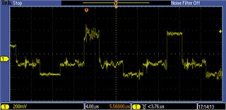

I am trying to achieve a VGA splitter (using THS7316) on our baseboard. We are using this for a VGA signal with a fixed resolution of 1024 x 768 @ 60Hz and connect to a display panel and a monitor.
Attached (VGA-2.png) is the circuitry that worked last time with a COM Express module. However, as the module has now changed the input to these VGA buffers is now coming from a Chrontel IC CH7517.

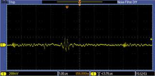

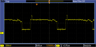

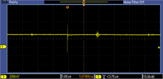

I have verified that VGA signals coming out of the Chrontel IC CH7517 is 0.7Vp-p using oscilloscope and VESA compliant when not connected to the VGA buffer THS7316. However, as soon as the buffers are connected there is a significant attenuation of the VGA signals at the input of the VGA buffer THS7316. The output of the VGA buffer THS7316 is also the attenuated signal with the DC bias.
Whilst I have now also tried the circuit by removing the AC coupling (capacitors) and employed a DC coupling as shown in the circuit (VGA-1.png) below, I did not see any improvement.
Even this results in significant attenuation of the VGA signals at the input of the VGA buffer THS7316. The output of the VGA buffer THS7316 is also the attenuated signal with the DC bias. Can you please suggest what I must do to create a VGA splitter circuit. Please note that the 150ohm resistor pull down to ground at the input of the buffer s a requirement of the COM module as there is another 150 ohm resistor on the COM module (at output of the Chrontel IC CH7517). This makes it a 75 ohm.
I have also tried using just one VGA buffer THS7316 to drive both the display panel & monitor and still it has the same attenuation with dc bias at the output. Can you please suggest a fix?
