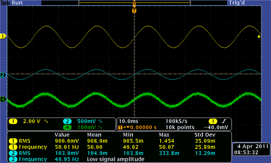

  • Hello Ron,
    Please see below two images. The first image shows the high gain amp output (yellow), the low gain amp output (blue) and the raw INVCUR_1/2 input (green), prior to any clipping at 1Amp mains current :
    The second image shows the same signal, but now with the high gain amp clipping severly (as intented) at a mains current of 6Amp. I have made a big step from 1 to 6Amps in order to see the distortion on the low gain amp output more clearly. As you can see, the distortion appears in the rising edges of the sinewave, while the current transformer output signal remains untouched :

  • Daniel,
    Thank you for the schematic and waveforms. They are very helpful. Your design is sound; I do not see the cause of the distortion in the schematic.
    I also no longer believe the cause is a loading imbalance during clipping.
    I have tested interaction between amps 1 and 2 in the lab and the result was negative. No interaction was observed.
    Have your observed this effect on more than one unit or board?
    I do not have a good theory at this time.
    Ron Michallick
