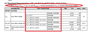

  • Kengo,
    HAST conditions are given in the above document in the red circle: temperature 130C, relative humidity 85%, test duration 96 hours.
    Before and after HAST, all parts are electrically tested to meet datasheet parameters under specified conditions (e.g. Vcc of 5.5V) - see below.

  • Kengo,
    If your question pertains to configuration used during HAST, the part is under quiescent conditions with input and output at mid-supply as specified at the top of the data-sheet table: Vcm=Vout=Vs/2, RL=10k connected to Vs/2.
    The easiest way to set this up is to use the op amp in a buffer configuration (G=1) with +/-2.75V power supply, positive input grounded and 10k output load connected to ground.
