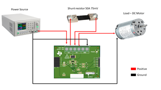

I'm trying to make a simple reading with the INA236EVM with a power source and a motor but on the GUI it doesn't show power and current readings. My system is connected like this:
I read the INA236EVM datasheet and it says to connect VBUS to pin 2 but on the board, it is written GND so I'm afraid to make a short circuit and damage the board.
Should I just make a jumper from the power source and connect to pin 2 of J1?
