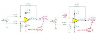

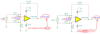

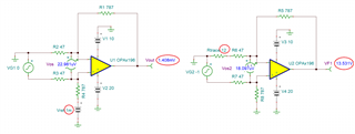

  • Adding to Tom's comments, what you get in terms of gains is exactly what you should see - see below.
    I believe the error comes either because your reference driver has offset (e.g. 1mV - see below on the left) or of due to mismatch in trace resistance (e.g. 12 ohm - see below on the right).  Of course, to Tom"s point using small resistors increases the current in each diff amp leg and thus exaggerates the problem.
    Changing gain will change the output simply because of the change of gain amplifying the offset. BUT you should not do this-offset must be calibrated out.
    I believe you have never told us what offset you actually see.
