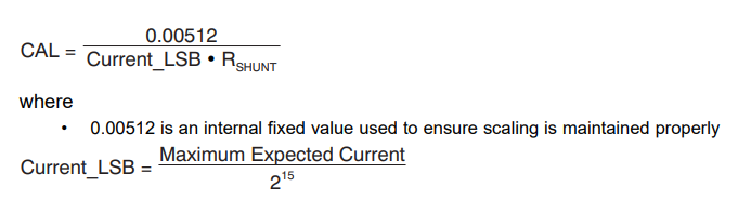

What is the calculation process of Calibration Register value?
The value I calculated according to datasheet is inconsistent with the theoretical value.

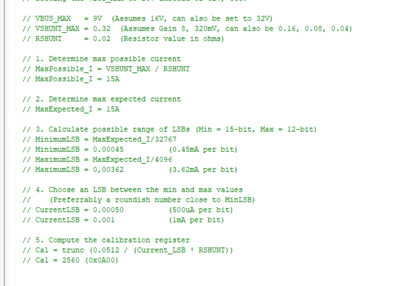

The calculation process of our former engineer with 1mΩ sampling resistance is as follow:
If I change it to 2mΩ now, could you tell me what to do with steps 3 to 4?

    There are a few issue's with the code. First the INA226 max Vshunt is  81.92 mV, so VSHUNT_MAX must be changed to .08192, this will give you a different Max current for your Rshunt. Also under number 5 the first equation should read Cal = trunc (.00512/(Current_LSB * Rshunt)). Rshunt is also equal to 20 mOhm, while you said the
    I will go over everything again for your 2m ohm shunt resistor:
    VBUS = 9 V, VSHUNT_MAX = .08192 V, RSHUNT = .002 Ohm
    MaxPossible_I = VSHUNT_MAX/RSHUNT = 40.96
    // if this maximum current is ok then great, if not select different Rshunt to satisfy your Max current, ie Rshunt = .08192/Max_Current
    Current_LSB = MaxPossible_I/(2^15) = .00125
    // or Current_LSB = MaxPossible_I/32768
    Cal = .00512/(Current_LSB * Rshunt) = 2048 (0x0800)
