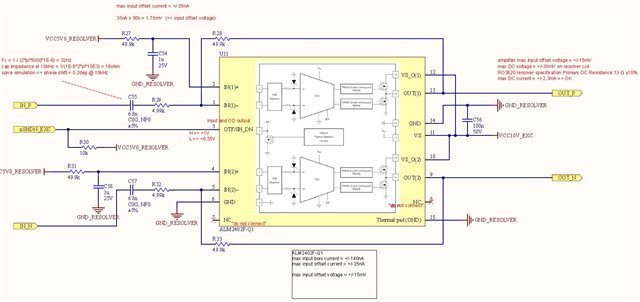

  • Hi Raymond,
    They are looking at ALM2403QPWPRQ1 to replace ALM2402F)
    (power supply is 10V)
    There is also a 1nF cap between each output and ground.
    The resolver is 13ohm in series with 2.15mH.
    Excitation frequency is 10kHz. Input is sine wave.
    The level between EXC POS and EXC NEG is about 14.4Vp-p
    BTW, do you have any other concern about replacing ALM2402F with ALM2403

  • Hi Mark,
    Could you resend a higher resolution image? I am unable to make out all the figures and comments from the image (I am trying to send you the simulation as the application is captured).
    Yes, 1nf will be ok. In my prior simulation for a customer, I had 10nf that is connected to ground, shown in red circle.

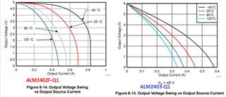

    They are looking at ALM2403QPWPRQ1 to replace ALM2402F:
    May I ask what features are you looking for in ALM2403-Q1 vs. ALM2402F-Q1? It mentioned that the application is a single supply voltage of 10V. I do not see that there is advantage to change from ALM2402F-Q1 over ALM2403-Q1.
    If you want to maximize the Vout swing under Vs = 10Vdc, ALM2402F-Q1 has the advantages.  ALM2403-Q1 has high supply voltage rail and can withstand overvoltage up to 24-26Vdc. ALM2402F-Q1 has the absolute maximum supply voltage rated up to 18Vdc.
