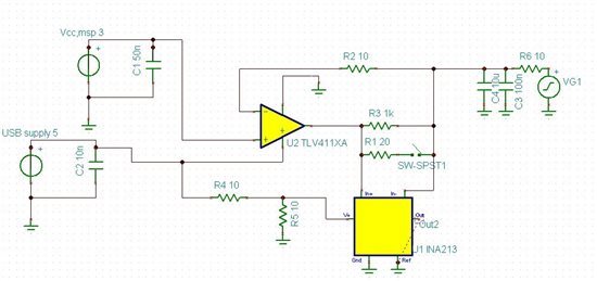

Hi guys,
I'm working on the design of a circuit to measure the current consumption of MSP430. Based on the specification of INA21x shunt monitors, these amplify accurately sense voltage of down to 10 mV. But according to TINA simulation results, INA21x suck with low currents, due to high input bias currents (I think) but this is not mentioned in the data sheet as far as I know.
I attached my circuit for your review. Unfortunately the TINA .tsc simulation file could not be accepted. The circuit has to cover the wide current range from 1uA to 100mA. I though to use the 1k resistor for currents lower than 50uA, then 1000ohm//20ohm for currents between 50uA and 2,5mA... and for higher currents I thout to measure Vsense directly with the ADC. I set V+ of the INA to 2,5V because the ref voltage of my ADC is 2,5 V
The resistor R6 and the source VG1 are ther just to siumlate the dynamic behavior of the processor.
Could you please help me answer to this questions:
1) why does the INA not work for low currents?
2) what do you think about my circuit, what can I improve in it to get accurate results?
Thnx
  • Hello MSP430-Beginner,
    Our dedicated current shunt monitors are designed for measuring high-currents with common-mode voltages that typically extend beyond the supply voltage range of the device.  They typically have uAs of input bias current which does not have significant impact on high-current applications, but does generate significant error at low-current levels.
    Therefore, you may be interested in our instrumentation amplifiers (e.g. INA131, INA110).  In addition to low input bias current you will want to look for low offset voltage (Vos) unless you plan on calibrating out the offset using an ADC.  Also, the lower the noise the better.
    The range you specify (1uA to 100mA) is very large.  I adjusted your low-end current to 0.1uA which is consistent with the LPM4 of the MSP430F2112.  Your high-current condition (100mA) seems rather large.  Nonetheless, after sizing the shunt resistor and performing a DC sweep, the output of the INA131 will saturate once the load current reaches ~20uA, which is nowhere near your high-current specification.  My simulation is attached for your convenience.
    The INA110’s gain can be adjusted by switching in different on-chip resistors.  This may allow you to extend the current range but after a quick calculation I put the maximum load current at approximately 200uA.
    Finally, you may be interested in one of our programmable-gain amplifiers (PGAs).  The PGA280 and PGA204/5 may be of particular interest.
    The issue again, however, is that the large sense resistor (sized for low-current) will quickly saturate the input and output voltage specifications.  Therefore you will probably need a precision resistive switching network for the sense resistor.  Combine that with one or more of the aforementioned devices and you can build your solution.
    Hope this helps.

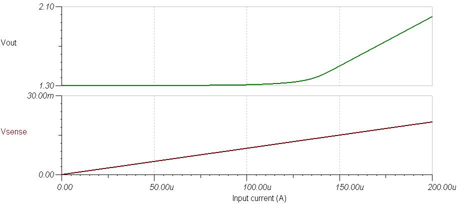

  • Hi Peter,
    thx a lot for the hint how to create the sweeps.
    Actually I can't supply my circuit with more than 5V. So I set V+ to 5V and Vref to 0V. I set Rsense to 100Ohm, because the smallest voltage accepted by my ADC is 1 mV(0,1uA*100ohm*100=1mV). I got the following results:
     And I do only get correct results when Vref>1,3V, so I set Vref to 1,5V and its working fine (as well as for higher reference voltages). Actually I can substract the offset of 1,5V and then forward it to the ADC, but I wonted just to know if I'm doing sth wrong to get this results, because this is not mentioned in the data sheet.

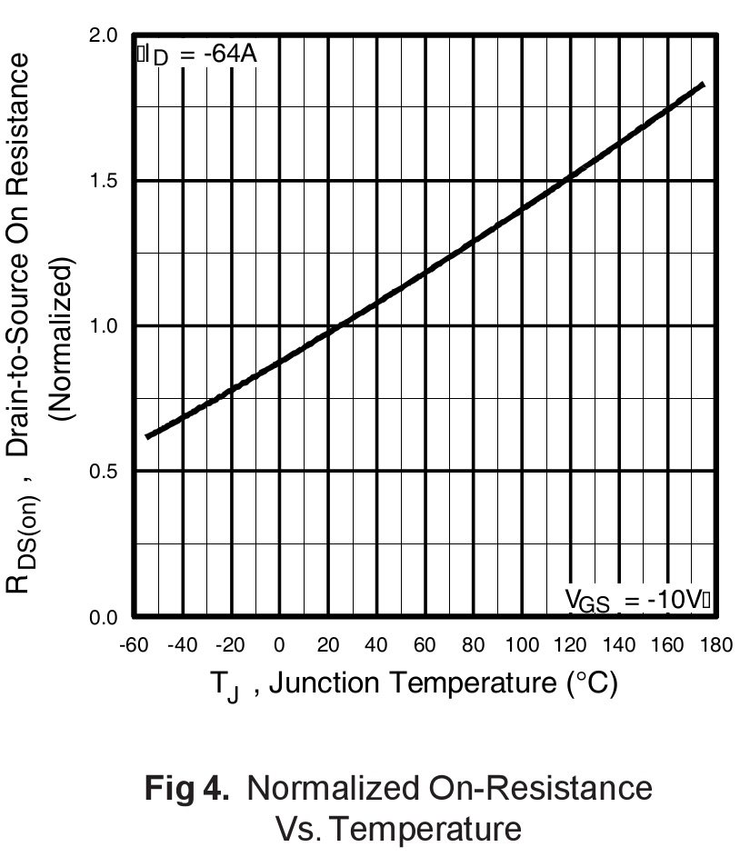

    I want to use INA213 to measure currents upto 10A through RDS-ON of P-Channel Mosfet IRF4905. The common mode voltage can be upto 26V. I dont want to put a seperate shunt resistor to keep the loses on a lower side. Please help and let me know if my idea can work.
  • Hello Anshuman,
    My first concern with this is that the common-mode voltage is at the absolute maximum specification for the device.  I would not recommend using the INA213 for such an application if the common mode voltage can go above 26V.
    We recommend using an external shunt resistor due to Rds(on) dependence on temperature, as shown below:
    In addition to temperature drift, I am unsure of the Rds(on) min/max specifications.  In other words, even if you temperature is well-regulated, each FET will have different Rds(on) values at a given temperature.  You would have to contact IR for the tolerance and/or distribution of this specification.
