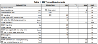

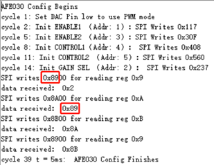

I try to read register, but obviously the data returned is not correct. It is the higher 8 bits (R/W bit and reg addr) of the data second last write to SPI.
