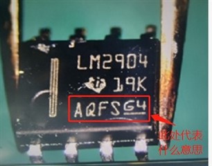

Please help explain the meaning of the letter "aqfsg4" in the figure below. Our customers require us to provide it.
Hello HY,
The G4 refers to 'green' (eco friendly) materials
The other four characters are for TI internal use only and characters change often. In others words, they have no meaning.
