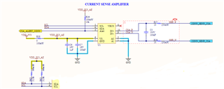

    1. Circuit schematic for the INA226? Especially the pull up resistors on SCL and SDA?
    >>Kindly find INA226 schematic below
    >>Pull up resistors are 2.21kohms

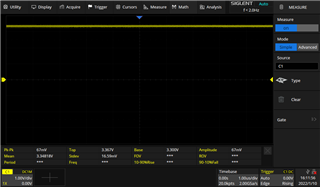

    >> Oscilloscope shots for
    Supply voltage: we are working on 3V3
    >>the SDA and SCL pin voltages
    >>The input common-mode voltage (VCM) at IN+ and IN- pins during when the shown charge & discharge profile occurs.

    I assume this is a low-side sensing application (VCM=0V = GND) because you provide the same waveform/image for the input VCM and input differential/shunt voltage even though the first image was detailed as being the shunt voltage across a 5mΩ, even though the INA226 is sensing across a 0.5mΩ shunt.
    Unfortunately, we really need the measurement of IN+ to INA226_GND pin and IN- to INA226_GND pin during the problematic load profile. This is the only way to know what the true absolute input voltage is for the device and whether or not there is a VCM violation of VCM< -0.3V, which the waveform is actually indicating albeit for a short duration.
    The other piece of information needed is that the INA226 ground is actually stable during the profile. To know this we need the differential voltage measurement between INA226 ground and system/load ground. Impedance between these grounds can lead ground loops during rapid transient. Here is a document explaining this phenomenon.
