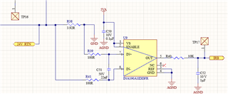

INA190: IN190 low side current sensing
Part Number: INA190
the above block diagram and my design is the low side current sense using INA190.
i have to measure the readback current of the my design.
i have taken the load as a GND.
i will measure GND to 24V  return  through sensing resistor .AGND and GND shorted
can i take this GND as load is it correct?
i have the GND connected to  reference pin  is correct?
