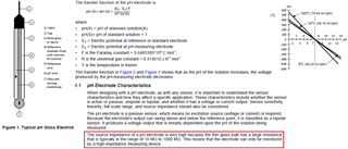

  • Hi Onkar,
    pH electrode vs. [H+] (hydrogen ions) concentration is a differential voltage measurement, where Es - Ex differential output is being measured via op amp (represented in mV on the vertical axis in the following plot). pH(S) is a typical standard neutral aqueous solution, where hydrogen ions' concentration [H+]= 0M, and typically calibrated solution is pH=7. Most important variables in the Nernst equation are Temperature and (Es - Ex) measurement, which needs to be accurately measurement. pH reference buffer solutions (used for calibration and linearity checks) are fairly stable and does not change over time.
    In my opinion, there is no point to measure the impedance of a known and working pH electrode in your application. The reasons are the pH  impedance are going to change from time and time, and you may only be able to obtain an approximate figure. The impedance is based on the ionic impedance, it will change over temperature, solution concentration, frequency, applied measurement potential by measurement device etc. (a difficult measurement as suggested by Kai). The impedance at DC does not have much meaning in your circuit, because it is going to be high in MΩ -GΩ range (H+ exchange rate is going to be in sub-Hz or mHz range).
    As you and Mike pointed out, the application does require a very low I_bias op amp, preferably is in fA or no less than pA range. The differential current is very low and the pH potential measurement should not "overload" pH electrode in the measurement process. If pH electrode is overloaded during potential measurement, it will alter your results and (Ex -Ex) vs. pH plot will not be a linear relationship.
