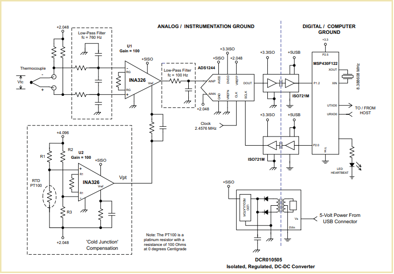

Good Day. I have a customer who is working with INA326. Please see below his query for your reference. Thank you very much.
In app note SLOA123 (https://www.ti.com/lit/an/sloa123/sloa123.pdf?, page 1), it shows using an INA326 amplifier to interface to a thermocouple. For the RFI filter, it shows using series resistors. For these resistors, do they need to be matched better than 1%?
