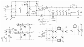

  • Hi Kai,
    The u-feedback should connect to a resistive divider of output voltage such as the attachment.
    I did not also find a negative feedback loop between IC4A and IC4B , So I confusesd how the u-feedback follow the P1 (required voltage). Might there be something wrong in the origional circuit diagram?

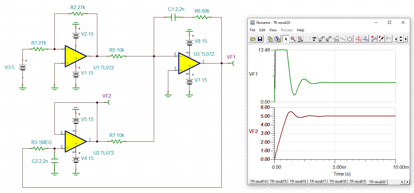

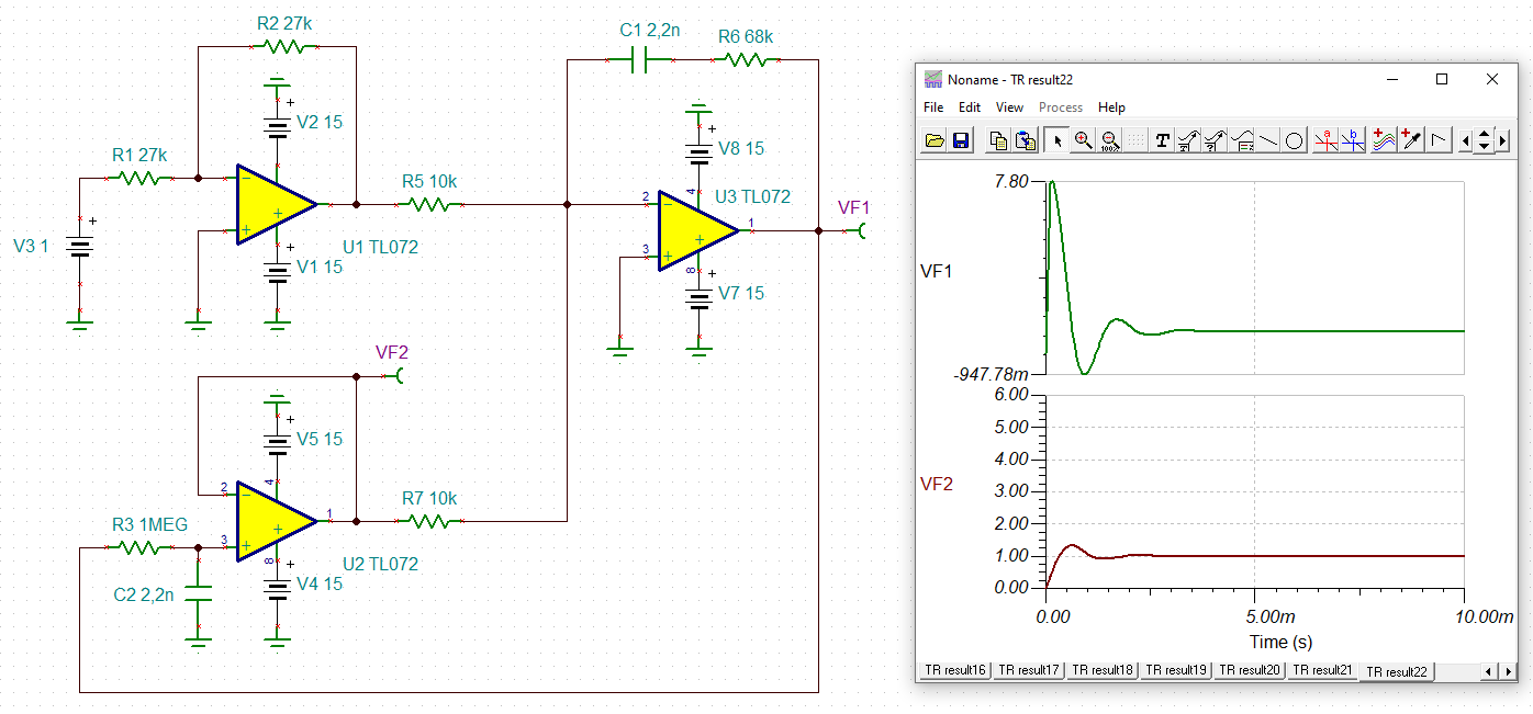

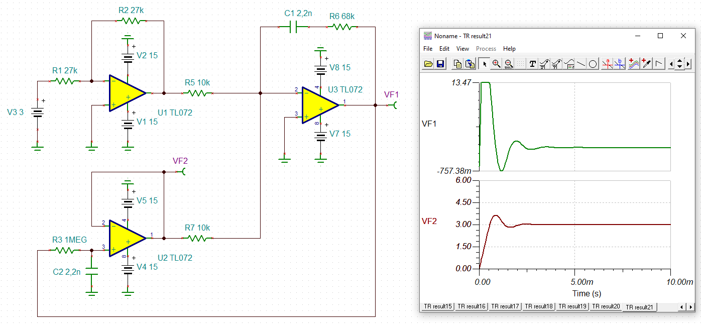

  • Hi Kai,
    I did not find the SG3525 chip in Tina simulation software, Could you show the simulation circuit for the original design circuit in Tina or other simulation software ?
    According to my understands the PWM-duty only is a variable DC voltage whose range is about 0.9V - 3.6V that is for chaging the pwm duty form 0 to 100%. The u feedback  should be a various dc voltage whose fuction is to control the output voltage through the divider resistors (R6+R7)/R7. If the u feedback can follow the voltage setting , there should be a negative feedback loop between IC4 - and pwm-duty or other circuit , however , there should consist a error amplifier among IC4A, IC4B , IC5A...., right ? but i could not find the negative feedback loop.
  • Hi Meng,
    as I already said, you have to close the feedback loop. Here some examples:
    meng_tl072.TSC
    Kai
