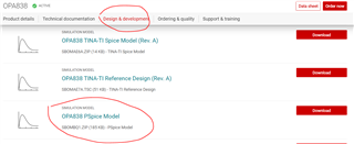

  • Can you tell us what simulator you are heading towards - often, that is LTSpice. Normally, to port into LTspice you just need the netlist text file and then attached that to the correct symbol. Here is the model text file, I saved it as a .lib file normal for LTSpice, but if you don't like that just change it.
    OPA838 2018 model.lib
    But, TI has started to also provide Pspice models as shown under the correct tab in the product folder
