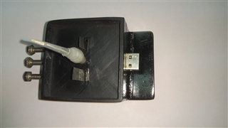

This is a circuit of cyclic voltammetry in which all three electrode i.e. WE (Working Electrode), CE(Counter Electrode) & RE (Reference Electrode) are dipped in electrolyte solution.
The source voltage is -1V to +1V (mentioned in circuit) but generally we are using -0.2V to +0.6V as scanning voltage. During scanning (-0.2V to +0.6V), I have measured the voltage between working electrode (WE) and reference electrode (RE) which is -0.4 to +0.8V (approx.) which should be -0.2V to +0.6V and this is happened due to electrolyte (solution resistance).
The circuit may need to improve by taking feedback from WE & RE to make it exact -0.2V to +0.6V.
I want few suggestion for circuit improvement.

    8. Please send us a close image of your 3-electrode chemical cells.

  • Hi Nirav,
    Let me comment on the 3-electrode setup first.
    I am not able to see how the internal 3-electrodes are configured. Typically the WE has to be parallel with CE and REF electrode should be positioned closer to WE electrode and on a side of WE electrode (not directly in front of WE electrode to block the ion flows under redox reaction). The CE and  WE electrodes should be face to face to maximize the ionic charge transfer between two electrodes (itwo plates in your case).
    In 3-electrode chemical cell, CE is sourcing the required current for a given applied potential between WE and REF electrode. The applied potential from -0.2V to +0.6V are referenced to REF electrode.  When chemical reaction are taken place at WE electrode, electrons are produced (source or sink in current at WE depending on the applied potential to REF). The current to voltage conversion is done via TIA circuit.
