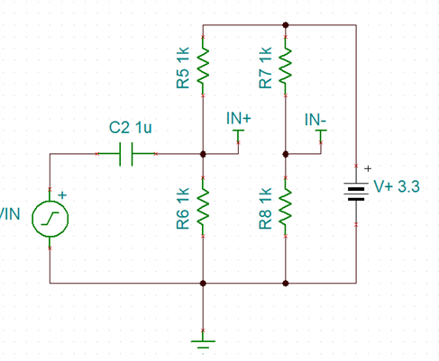

Hi, Kai and Joe
here is more inputs, supply voltage is 3.3V, noise is 20mV. input signal is single-end +-1.5V 2MHz, bias is 300mV. output is 3.3V LVCOMS
BR,
Chi
Hi Chi,
Thank you for providing more information. From what I gather, your input signal will swing from -1.2V to +1.8V for a total 3V swing? I am not sure what you mean by the bias is 300mV.
Assuming that your 20 MHz input signal is close to 50% duty cycle, you can AC couple the input (IN+) and set the common mode voltage with a resistive divider.

Hi, Joe
yes, it is the case using AC coupling in IN+ and duty cycle is 50%.
in my understanding, IN+ have +1.5V to -1.5V voltage range, it will be over our supply range 3.3V, it still will work? or using resistor divider in IN+ to decrease the -1.5V in IN+
BR
Chi
Hi Chi,
Your application will work if you AC couple the inputs and set your bias voltage of the resistive network to 1.5V.
This would result in your input swinging from 0V to 3.0V.
After doing this, the threshold has to be increased to 1.5V or 1.8V if you would like that 300mV bias you mentioned.
Please let me know if you need further explanation or clarification.

Hi Chi,
if the signal is a square wave, then even a simple diode level shifter could do, sometimes:
The two diodes do the main level shifting. R3 is the assumed source impedance. R1 and R2 limit the current through the diodes and into the source. R1 helps to make the shifted signal better fall into the desired 0...+3.3V window. R4 helps to minder the spike current through the 10pF load capacitance in the moment when the source signal toggles and this without affecting the level shifting.

Hi, Chuck
customer has accepted this solution, and didn't have any more question so far.
Thanks a lot for your help
