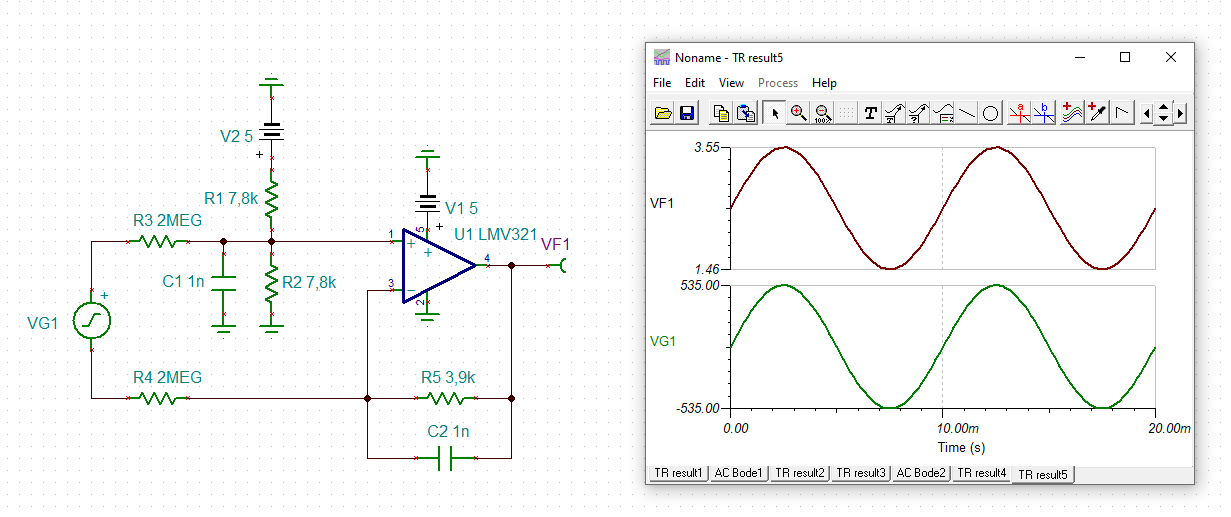

Dear team,
Please review below schematic and waveform.
- Gain : 0.00195 V/V
- Vpeak (AC) : 535 V
- DC offset : 2.5V
so I expected output as 1.4835 ~ 3.5165 but test result is 0.42~4.58. It seems the gain is 0.0039 not 0.00195.
please review it and let me know your opinion regarding schematic /waveform and what i missing.
