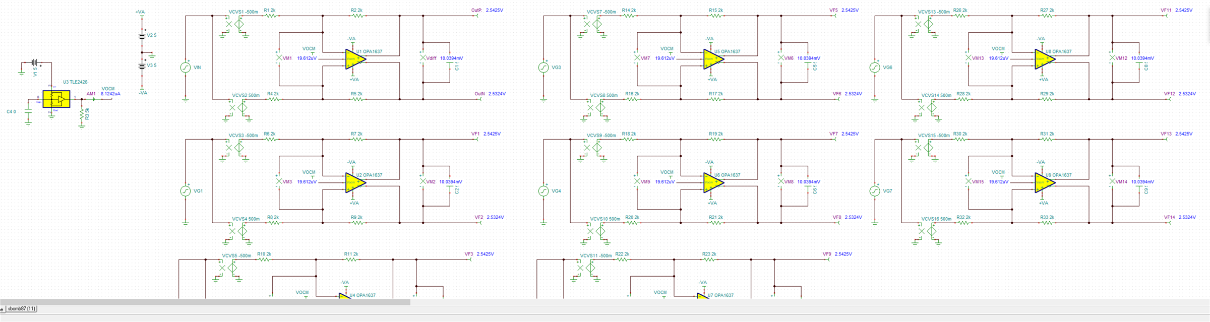

TLE2426: TLE2426 is sufficient for supply 8 of Opamp(OPA1637) VOCM?
Part Number: TLE2426
Other Parts Discussed in Thread: OPA1637
Hello I am Jung
I am using TLE2426 for DAC to supply 8pcs of OPA1637 for VOCM.(Mid bias)
I found a problem which is the output of TLE2426 is only 0.7V.(I expected 2.5V because input voltage is 5V)
However, ADC part of TLE2426 that is operating 4 pcs of OPA1637 output 2.5v fine.
I am not sure DAC part of TLE2426 is failure or TLE2426 cannot supply 8 pcs of VOCM of Opamp.
Could you please advice for me?
