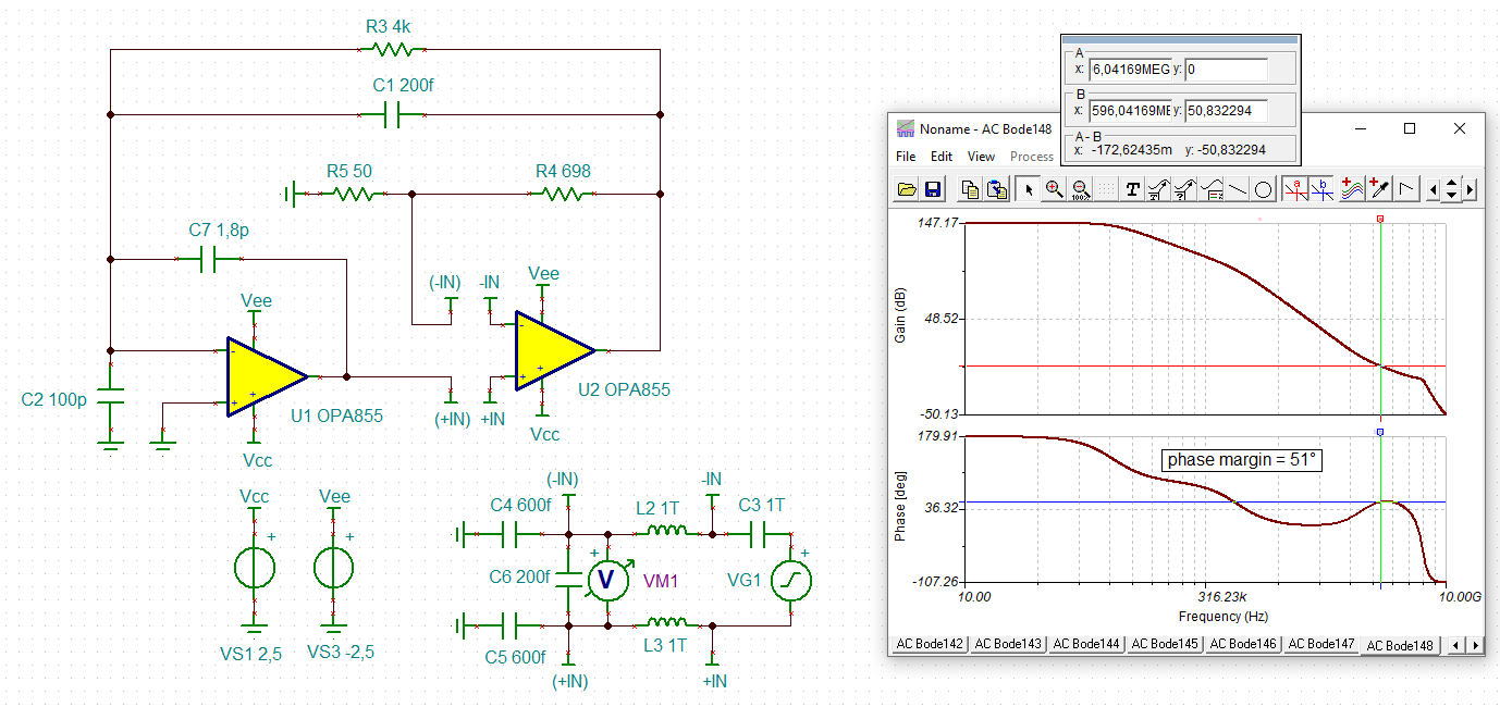

I am trying to design an amplifier to measure the time response of a photodetector (50pF detector capacitance). I'm trying to achieve bandwidth close to 500MHz with considerable (several KOhms) gain.
With a composite loop including OPA855 and OPA858 simulations looked promising.
Below is my original circuit snapshot with 4K gain achieving almost 500MHz bandwidth. I know this is on the edge of stability and expected to have some tweaking in the lab. However after following mods, the circuit keeps oscillating;
1. Increased RFB to 100K
2. Increased Cd to 100pF (0603 COG)
3. Various values for CFB ranging from 0-0.3pF
4. Added NP0 supply decoupling (few nanoFarads)
(added a snapshot of the simulation circuit)
Due to not having this kind of HF tools, I'm simply measuring the output with an oscilloscope.
The last hypothesis I had was the ESL of the input capacitor. Therefore I changed the package from 0603 to 0402 (0,6nH to 0.3nH). However it doesn't seem to solve the issue.
Based on TI experience, would it be even possible to get the circuit to work up to this high frequency or is there a fundamental limit of device/package parasitic?
Thanks in advance!
Sven

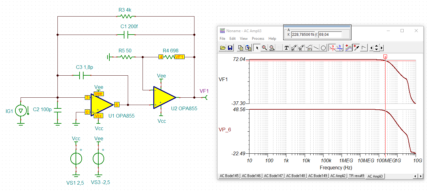

  • Hi Sven,
    your circuit is instable, unfortunately.
    But you could give this scheme a try:
    sven_opa855_2.TSC
    To increase the bandwidth you can slightly decrease C1 and/or C3.
    Keep in mind though, that it is rather difficult to exactly hit C1=200f. A bit too high and the bandwidth goes down, a bit too low and the circuit becomes instable. So it might be easier to adjust C3 to get proper results, and not C1.
    With the given component values the phase stability analysis shows sufficient phase margins:
    sven_opa855.TSC
    sven_opa855_1.TSC
    I haven't understood why bootstrapping doesn't seem to work. Can you show how the four photodetectors are wired?
    Kai
