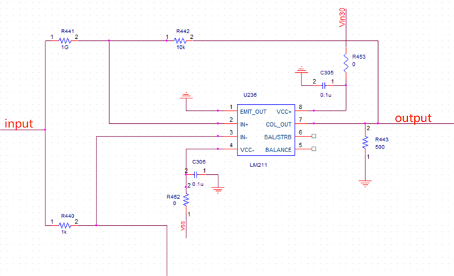

LM211: use lm211 to form a hysteresis comparator
Part Number: LM211
We want to use lm211 to form a hysteresis comparator
The input terminal is connected to the inverting terminal "in -" and the reference voltage is connected to the in-phase terminal "in +". When the input voltage increases from negative to positive, the output voltage is high. At this time, the reference voltage is UCC * R441 / (R441 + r442). When the input voltage exceeds the reference voltage, the output is low. At this time, the reference voltage becomes UEE * R441 / (R441 + r442) to form hysteresis comparison.
We want to know the feasibility of this scheme
