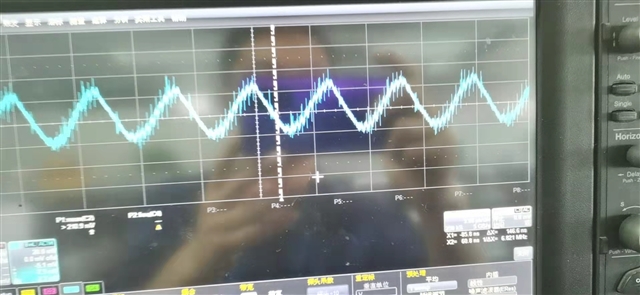

my customer use THS4541 in optical module, and have an application issue.
application: THS4541 convert AC single-ended signal into a differential signal. the signal is photogene rated current of pd from TIA.
PCB:
issue:
vin + ---> FB-_1 resistance is disconnected, the capacitor of output to the next stage is also disconnected, and a nearly 60MHz signal can be measured at the pin of FB-_1
in the simulation tools, customer also could see this issue
any advice?

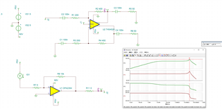

  • Hi Chi,
    what photodetector do you use at the input of OPA2354. I ask, because you also have to take into consideration the photodetector capacitance.
    Kai

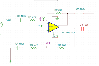

  • Your simulation shows a THS4520 FDA on +/-5V supplies, perhaps try a THS4541 on single 5V supply in simulation.
  • Hi, Kai and Michael
    I will check with customer for photodetector, but even disconnect the input, and use signal source to provide a small signal, FB pin will oscillate.
    customer don't know how to change the model, they will have try.
    do you have any idea to prevent this issue?
    BR
    Chi
  • If you attach the TINA file, we can change it - also provide the load after the blocking caps.

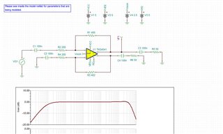

  • Hello Chi,
      Below is a simulation using the THS4541 on single 5V supply as suggested by Michael.
      Is this the exact setup the customer is using with the TIA disconnected? Also, the customer should use a low capacitance probe, otherwise an output resistor is highly recommended to "isolate" the impedance of the probe from the output pin of the amplifier.

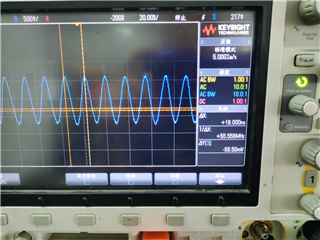

  • Hi, Sima and Michael
    we have test on board, also find the oscillation. here is the latest test condition, could you help to double check?
    some change: R1 and R3=7XR2, input signal is 60M sine wave, test point is left point of the C3
    test line using
    also test the point in the right of C3. input signal is 30MHz sine wave.
    Br
    Chi
  • Hello Chi,
      Are they using this circuit as an attenuator with the feedback resistor changes? With attenuators, additional compensation is needed for stability under unity. Also, it is best to probe after an isolation resistor due to the capacitance/impedance of the probe.
      Was there oscillation with the setup including the 400Ohm feedback resistors?

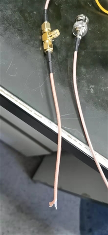

  • Hi Chi,
    hhm, why not connecting the scope this way?
    chi_ths4541.TSC
    Kai
  • Thanks for your advice. will try and feedback.
    BR
    Chi
  • Hi, Kai and Sima
    thanks for your advice, this works, didn't see any oscillation now.
