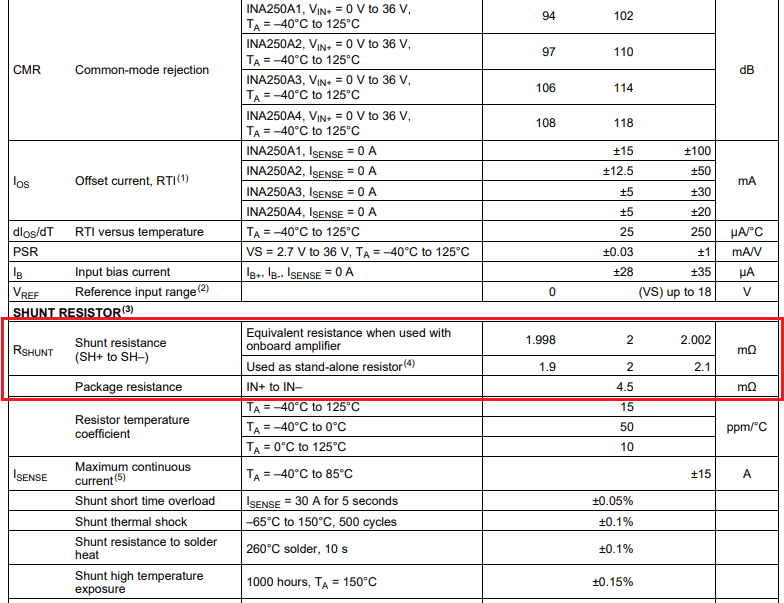

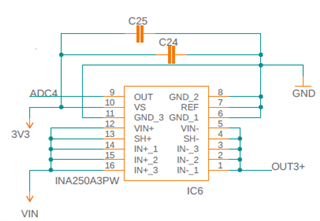

I am currently consistently getting 235% of the output voltage compared with what is expected using an INA250A4 and an INA250A2.
For example, using the INA250A4, with a current of 0.5A, the output is 2.35V which correlates to a reading of 1.18A. The same multiplication of expected output occurs with other currents passed through:
Voltage Ohms Expected output V Actual output V Expected Analog Actual Analog Calculated Amps Actual Amps %
12.00 14.10 1.70 #VALUE! 2112.19 N/A 0.85 #VALUE!
12.00 24.00 1.00 2.35 1240.91 2920.00 0.50 1.18 235.31%
12.00 38.10 0.63 1.47 781.68 1830.00 0.31 0.74 234.11%
4.46 14.10 0.71 1.48 880.08 1840.00 0.32 0.74 234.39%
4.56 24.00 0.42 0.89 517.05 1100.00 0.19 0.44 233.28%
4.60 38.10 0.26 0.56 325.70 700.00 0.12 0.28 233.61%
The amperage has been checked and matches the calculated values in the table above as the entire system consumes only ~0.4A in addition to the load circuitry.
INA250 Implementation
