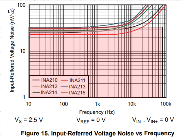

According to the tutorial in TI precision lab, current sensing amplifier's error(worst case) can be listed as below-
% ≈ + + + _ + + ℎ_ + _ + ℎ
However, voltage noise density error isn't listed above, is there any way to calculate the error caused by noise?
Thanks.
  • Repost my question, since some content isn't shown.
  • Charles,
    We don't list noise in the above equation, because the equation looks at accuracy based errors, where noise is a precision error.
    For our analog devices, to calculate noise, you must find the integrated voltage noise density in the datasheet (shown below), and multiply this by the square root of the BW to achieve the RMS noise. Then, you may multiply this value by 6 (or 6.6 for 99% confidence) to achieve the peak to peak noise.
    For our INA213, you can see from the datasheet that the BW is 80kHz. For the noise plot, I would suggest finding the additional area under the curve for a more accurate measurement, but a quick way to achieve theoretical results is to simply take the flat portion of the curve as the totality, as shown below:
    Then, this shows that, without any filtering on the output, the noise of the output signal will be
    noise_RMS = 7.07uV_RMS
    noise_p2p = 46.67uVpp
    If you wanted to reduce these numbers, the equation shows that this nay be accomplished through reducing the BW of the device.
    Let me know if you have any questions.
