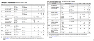

I'm sure this is in the DS, but I don't find it.
Where is the difference between TL072CDR and TL072BCDR?

Hey Fred,
Here is a side by side of the electrical characteristic tables between TL072C and TL072BC
