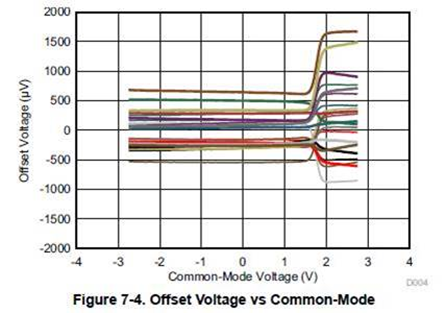

Customer gets back for another question about offset. In our datasheet, we have offset voltage vs common mode chart, would the temperature influence this performance?

Hey Cera,
This can be found in the datasheet's electrical characteristics:
