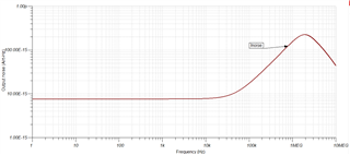

Good Day. For the simulation in ADS, customer is need the input noise current figure for TLV6001. Do you have this figure/curve? Please advise. Thank you very much.

Hello Ray,
The current noise vs. frequency figure can be generated using the TLV6001 macromodel. Recall, this figure simulates typical device performance.
I have attached the Tina simulation file below:
Please let me know if you have any questions.
BR,
Jacob

Thanks for your prompt answer. But I need the figure of the input noise current like the input voltage noise in the datasheet. From your simulation file, my analysis is there is no 1/f noise for the current. I am very surprise when I compare for another operational amplifier.

Hey Ray,
Is the spec from the data table enough?
This product is inherited by our product line and in turn the datasheet looks a little different and it doesn't have all the curves we are use to using.
When we make the models, we use the typical spec in the datasheet as the current noise density at 1/f frequency in fA/rtHz and also as the broadband current noise density in fA/rtHz.
