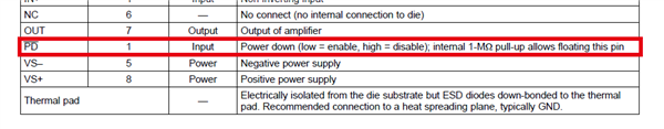

opa818 datasheet, From the figure above, PD appears to be low active;
However, from the figure above, PD seems to be high active, Whether it's high or low to active of the PD pin? Please explain to me the red boxes in these two pictures.

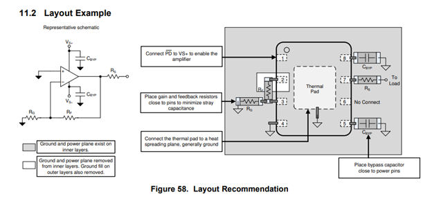

First, please take a look at this excerpt from the Layout Guidelines section, 11.2 Layout Example:
As you can see, the PD (bar) pin must be connected to VS+ to enable the amplifier. The PD (bar) pin is active low, in the case of the OPA818. The values present under the Power Down table under Electrical Specifications match the 'active low' nature of the PD (bar) pin: a voltage no less than 1V lower than the VS+ supply is required to power on the amplifier; a voltage no greater than 3V lower than the VS+ supply is needed to turn off the amplifier.
Put another way:
To enable the amplifier: PD(bar) > (VS+ - 1V); which would be PD(bar) > 5V for a 6V single supply (VS+ = 6V).
To disable the amplifier, using the active low PD(bar) pin: PD(bar) < (VS+ - 3V); which would be PD(bar) < 3V for a 6V single supply (VS+ = 6V).
These stated values align with the datasheet recommendation in section 11.2 of setting PD(bar) = VS+ supply.

The Pin Functions table states: "Power down (low = enable, high = disable); internal 1-MΩ pull-up allows floating this pin".
The terms 'low = enable' & 'high = disable' are referring to the PD(Bar) function, not the power state of the amplifier. The PD(bar) pin (& function) is enabled when at a low voltage, which would disable the amplifier. The PD(bar) pin is disabled at a high voltage, such as VS+, which would enable the amplifier.
