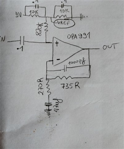

Hi Team, seeking your assistance.
The opamp being used is an OPA4991, but I would like to refer to the single OPA991 to make my question easier.
The first stage on the whole circuit will help me understand how I can proceed further on and it's a simple non inverting amplifier gain stage. I want to know if, when powered at 9v, can the opamp drive the load created by the input resistor value of 270R and the feedback resistor being 735R? I want to know if this is too low for this opamp or if it will affect the sound in any less desirable way?

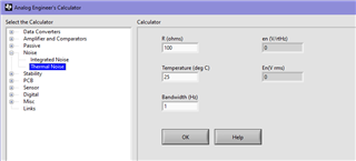

A second question is, I am using 10k resistors to form a Voltage Reference. Would it be safe to use smaller value resistor here too to reduce Johnson's noise? If so, how low can I go using this opamp?
Thank you.
