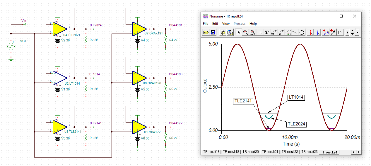

  • Hi Ibrahim,
    keep in mind that a usual single supplied OPAmp with the negative supply voltage pin being connected to 0V cannot fully go down to 0V at its output. And even if the saturation output voltage is very close to 0V, the OPAmp performance like the linearizing open loop gain or the speed begins to degrade at some higher output voltages. In the following simulation a 100Hz sine wave input signal swinging from 0V to 5V can be seen:
    And with zoom:
    ibrahim_tle2024.TSC
    If the output voltage really must go all the way down to 0V, one remedy is to use a small negative supply voltage at the negative supply voltage pin, for instance provided by the help of LM7705.

  • Hi Kai,
    Sorry for the late response, I'm very busy these days and still searching the best option for this issue.
    You have pointed out an important issue that I forgotten to check. Thank you.
    Minimum output voltages beyond 0.5V is completely useless for my application and min 10mV is very fine.
    Zero to 0.5V range is "out of range" region for most of the 5V analog sensors.
    I'm not prefer to use negative supply.

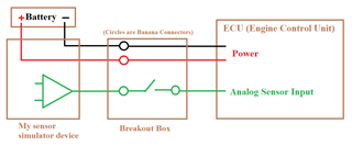

    I'm driving the ECU analog sensor inputs. They have 1k to 100k pull up or down to GND/12V/24V/5V.
    In this case the worst scenario is 1k pull-up to 24V when the opamp output driving to zero volt requires 24mA.
    Only a few pins requires this much current, most of them requires only a few mA current.
    And these pins are exposed on the breakout box, so the user may short that pins to the either rail mistakenly.
    Most likely the short duration will be a short time, but if the user don't notice the short due to the misconnection, longer short durations possible.
    One short in a multi channel device is OK.

  • Hi Mete,
    even if an OPAmp is used which provides a short circuit protection, I would make it impossible to directly touch +24V or 0V in the switch box anyway, as shown below:
    With this scheme when installing the desired pull-up or pull-down you can never directly touch +24V or 0V and the current is always limited by the permanently installed 1k resistors.

  • Hi Kai,
    Thanks for your proposal. My situation is not same.
    BreakoutBox and the ECU are not touchable, I'm only designing the simulator device.
    Users will need to test Short faults on the sensor pin at ECU side by the BreakOutBox.
    Inserting these S2GND/S2Batt faults is frequently needed in ECU application software development.
    And a flying wire will be used by user to short and doing wrong side short possibility is high during the tests.
    So protection for direct touch between the battery and the opamp output needed.
    Thanks, Regards,
    Mete
