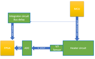

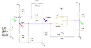

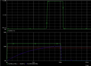

Hi team,
I am looking for a delay circuit, the application as the attached picture, MCU output 24V control signal, I want FPGA and ADC to read V/I value 8us after 24V control signal is pulled high, delay circuit send the signal to FPGA, FPGA start SPI communication and read data from ADC. MCU and FPGA are at different modules.
I am not sure amplifer  integrator circuit is suitable for this application, or any other recommendation, any comments are appreciated.
