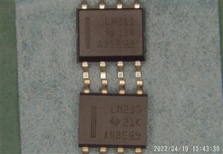

Hi team,
The mold shape of LM211DR has changed, but this change has not been announced.
Please explain why there is no PCN letter.
I assume it is related to JEDEC standard.
Both assembly sites are in Malaysia.

    I see there are two leadframes in use in use in Malaysia - the standard leadframe and the newer roughened leadframe. The different leadframes may require different molds. Both use the same base leadframe material and mold compounds.
    It is a little difficult to tell, but the upper "18K" looks to be the older "smooth" leadframce (shiny), and the lower looks to be the roughened (not shiny) leadframe. There may be a mold ID on the underside of the package.
    There was a general PCN in 2021 about the change in the labeling font, to the new "OCR"-friendly font across a wide number of devices (which is visible on the bottom "21K" device).
    Both packages should meet the "D" package drawings width and height specifications (within JEDEC MA-012AA).
     SOIC (D) | 8
    My guess is that a change in the leadframe style (not materials) may not be notifiable as the base materials did not change and it is still within the package specifications. I will double check.

    I does look like two different molds are being used. The lower package does not have a defined pin 1 side bevel and there is less "flashing" between the pins.
    Again, I am confirming if changing the leadframe is a notifiable PCN event for a general purpose, catalog (non-automotive) device.

  • Hello Takashi,
    I received confirmation that changes in the mold fixture does not trigger a PCN for commercial catalog devices.
    Other than the leadframe "roughness" and internal structure, the materials (mold compound, bond wires, mount compound, leadframe base material and plating) did not change.
    So you did not receive a PCN because it was not required. The roughened leadframe is being rolled-out across TI, so you may be seeing this on other devices in the future.

    Though the leadframce changed slightly internally, it did not change the external Form, Fit or Function. It is still within the "D" package drawing specifications and electrically there is no difference. This is considered a minor change from the customer perspective.
    The new "roughened" leadframe actually improves solderability and package lead-pull strength as it increases the surface area (like roughening-up a surface before gluing). So it is an improvement!
    So, yes, it complies with J-STD-046.
