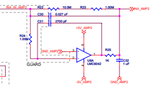

since 15 years we are using one LMC6042  through hole component in existing system, but i do not know how to give the guard ring for smd pack. i would like know how to give the guard ring  for smd pack.
If i go same part of SMD shall i use same guard ring? or need to change anything? please give me some guide .....if i go smd pack instead of throgh hole.

    We can give air wiring /guard ring top and bottom  for through hole components  but  we can give the guard ring on the top layer  for smd but   we  can not give air wiring for smd. Without air wiring is it create any issue ? and is it enough guarding clearance for using SMD part.
    Because we are using high sensitive or high impedance signal interfacing (p02,lac,glu)to LMC6042.

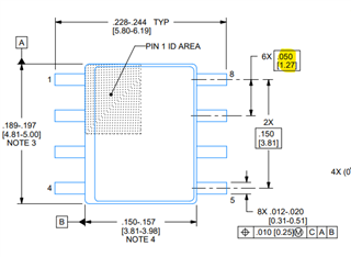

  • Hi Thirumal,
    as Carol already mentioned there's enough space for the guard ring between adjacent solder pads. Distance between adjacent solder pads is 1.27mm. Recommended width of solder pads is 0.6mm. Additionally subtracting two times the clearance of solder mask of 0.05mm gives a solder mask bridge of
    1.27mm - 0.6mm - 2 x 0.05mm = 0.57mm
    Even with a clearance of 0.07mm the soder mask bridge will be 0.53mm. This is fully enough for almost all manufacturers of printed circuit boards.
    And you can easily place a 200µm wide copper track under this solder mask bridge between adjacent solder pads. 0.53mm - 200µm = 2 x 165µm resulting in a 165µm solder mask overlap at both sides of this 200µm wide copper track. This is also what an usual pcb manufacturer can easily make.
    Of course, if you are not willed to use a solder mask, serious issues can occur durign the soldering Relaxed Then you would profit from taking the LMC6042 in the DIL8 package or from taking the LMP7721 with the special pinout.
