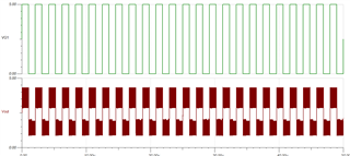

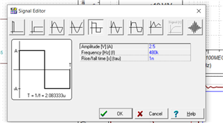

Hello Together,
I am using OPA855 in my design. While doing the simulation I am facing some issues. Kindly refer to the attached schematic.
Even though the op amp is rail to rail, the output is clamping at 3.1 to 4V, Same at the low side also.

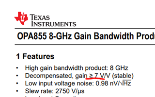

What is the reason for this clamp and what is the reason for ringing in the output?
And in the simulation model, there is no feedback pin also, but in the datasheet, it is there. Whether this might be the reason for the issues
