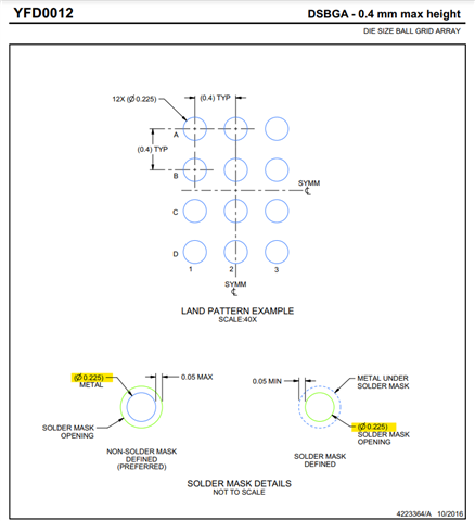

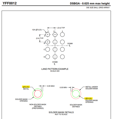

Hi Team,
My customer is designing with the INA231AIYFFT but they are also co-designing the INA231BIYFDT as a 2nd-source option in case they face shortage in the A part after production.
We wanted to know if these devices can share the same PCB layout as we found a slight difference in solder mask.
INA231AIYFFT:
INA231BIYFDT :
Would the highlighted differences in the two pictures above be an issue if we're using the INA231AIYFFT pattern for both devices on PCB?
