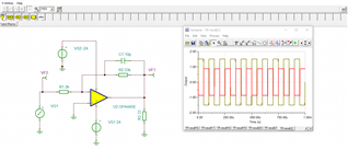

I am designing a new product using the OPA445. I have tried to simulate it using Tina but the output does not seems to be amplified. Can anyone help?
Attached is the screenshot.
Let me know if you have any questions.
Than you.
Vincent.

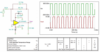

Hi Vicent,
As Kai pointed out, the simulated OPA445 exceeds its current limit. The Gain = -16.5V/V, and output should be -16.5V/V * ± 0.9Vpk, if I assumed the red color is your input signal, please see the image below.
If you have additional questions, please let us know.
