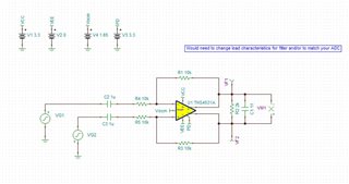

THS4541-Q1 datasheet says: input common mode Vs-1.2V
Vs=3.3V so I would expect a Vin_cm max of 2.1V
I simulated it with a similar part number THS4531 with input common mode of 2.5V and peak of 3.5V ( more than Vs)  and it seems to work fine. Do you know what is the max input common mode?
