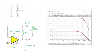

I did simulation with TINA for TLV9002 voltage follower but, the result of AC transfer characteristic analysis is wrong.
could you review my simulation setting or circuits ?
 1333 - Stability 3 - Problem 1 -Solution.TSC
  • Hi Hyun,
    yes, because the TLV9002 is hanging in saturation. Bias the +input of OPAmp at midd-supply:
    Kai
  • Hi Hyun,
    Kai is correct, the op amp output is saturated.
    I always recommend running a DC nodal analysis to verify the output is not being driven into the rails.
    Please let me know if you have any questions.
    Jacob

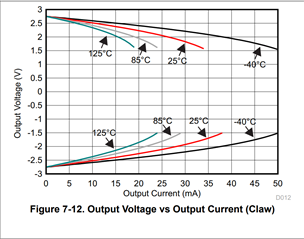

    As for datasheet specification, the term somewhat varies depending on the device (VOL, VOH, Output swing). Recall, output swing varies with output current, so the claw curve of the device is usually a good bet for understanding how close to the rail the amplifier can swing:
    We also specify typical swing from the rail when configured in a typical test circuit (10k load with mid-supply Vcm):

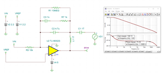

    (Q1) I did simulation as your advice , phase margin is stable (76 degree) but gain margin is unstable (108dB) .
            In order for the system to be considered stable, shouldn't the gain margin be negative?
            How can i understand result of gain margin ?
     (Q2) As I know, C2 and R7 is for stability fine tuning . I did change C2 (100nF -> 1nF) and R7 (100k -> 1k) but there is no change bode plot curve.
             please review this case .
  • Hi Hyun,
    If V(+) is 5V and V(-) is 0V , TLV9002 can output from V(+) - 10mV  and V(-) + 10mV ? (RL = 10k , typical Vo)
    This is only the output saturation voltage. The OPAmp will not run in its linear operation range when hanging in output saturation. To make the OPAmp run properly you should look at the "open-loop voltage gain" specification in section 7.10 of datasheet. And this says that you should stay 50mV away from the supply rails.
    Hhm, I don't know what you mean. The negative scale on the vertical axis is a simulation artefact. Add to all phase values 360° and everything will be fine. It's fully normal for a standard OPAmp that the phase goes to +180° at very low frequencies.
    Kai
  • Hi Hyun,
    I don't see any effect on the performance of this circuit. Where do you have this circuit from?
    Kai
  • Hi Hyun,
    Can you share the goals for your circuit (Integration frequency range, and gain requirements)
    The circuit you designed looks stable to me.
    The Analog Engineer's Cookbook contains a guide for designing integrators, link here: Integrator circuit
    I find this guide to be helpful for selecting components and amplifiers for realizing a functional integrator.
    Jacob

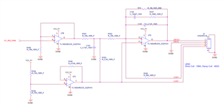

     amba_dciris_tlv9002.TSC
    I'm just want to know about stability of integral circuits and the role of around passive element (R , C) along feedback line.
    anyway, below circuits is good simulation model for stability check. right ?
    what do you think about the role of C3, R7 ? I was thought C3, R7 is compensation element for tuning stability but the simulated result is not followed by C3, R7 changed value.
  • Hi Hyun,
    this cannot be answered with certainty without knowing the load in detail.
    It doesn't seem to have to do with phase stability but it could be an equalizing scheme to modify the frequency response at the low frequencies or the relict of such an equalizing scheme.
    But why not asking the manufacturer who gave you this circuit?
    Kai
  • Hi Hyun,
    I agree with Kai, I was unable to find any significant influence to stability in implementing C3 and R7.
    Please let me know if you have any further questions.
    Jacob
