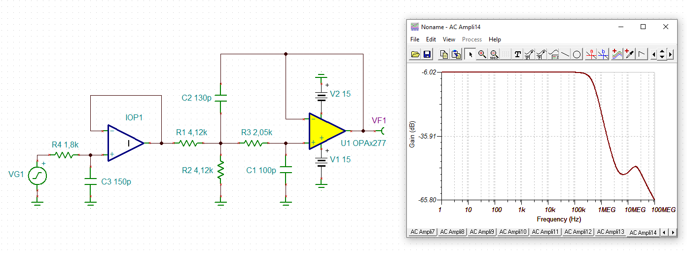

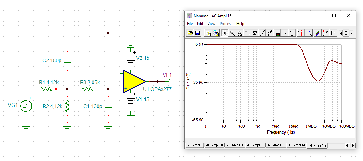

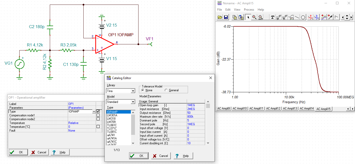

Can you explain me this problem on this simulation of a low pass filter.
This signal rise at 30Mhz. How to eliminate this problem?
Do you have an application note that explains why we have this rise?
