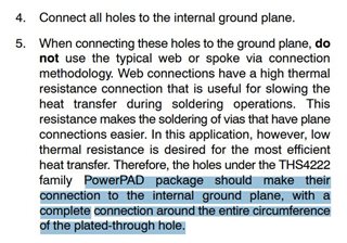

I need now to switch, for power dissipation reasons, to 8HVSSOP package with PowerPad (THS4222DGN); in most of ExposedPad OpAmp Packages the ExposedPad usually results to be Electrically Connected to Negative Rail (-Vs), however according to THS4222 Datasheet it seems that in this case the PowerPad IS NOT Connected to Negative Rail (Page 21 shows that also for Dual Supply the PowerPad is connected to GND Plane, and not to -Vs).
I just would like to have confirmation that for THS4222 the PowerPad IS NOT Connected to Negative Rail, and that I can safely connect it to Ground Plane while connecting -Vs to a Lower Potential respect to GND.
