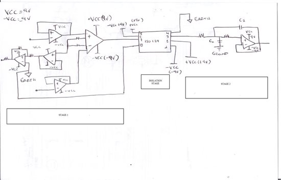

  • HI, I NEED A HELP ABOUT ISO 124 PLEASE. Here says:http://e2e.ti.com/support/amplifiers/precision_amplifiers/f/14/t/156139.aspx#566041
    I don't speak 100% english. I apologize if you find mistake in this. I bought iso 124 cause i need isolate 2 stage, and i am confused because i wanna use only one battery (9V=VCC) for my circuit, iso 124 requires 2, but i have questions, can i use voltage regulators for the other VCC and -VCC? or what supposed to going to do? and the battery has one ground, and i dont know if can i use that ground for stage 1 and stage 2? (Figure 1) My teacher told me with DC/DC Converser, i found MC34063A but this does not have its own ground, somebody can help me how can i use iso 124 with only one battery?
    Thank you, i hope your answer please! I need it soon.
